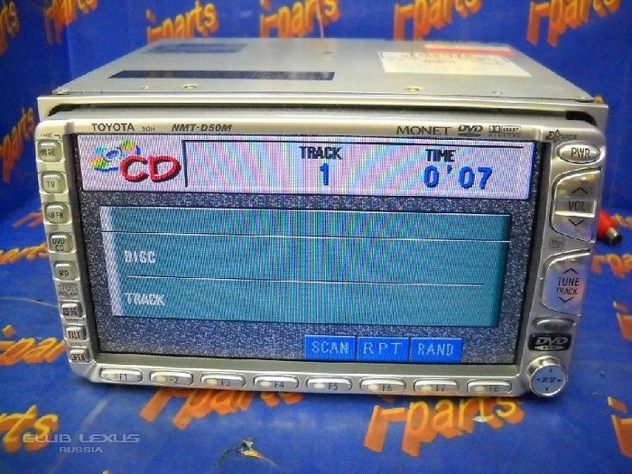

I do have a Japanese import navigation system: NMT-D50M
Japan Hybrid Navi Disc
But I would like to get it running in Europe (I live in Germany). From searching your forums I have found that you guys have quite some experience in things like these.
Can anyone give me some information how to create a Europe/Japan hybrid disc to get it running in my Navi? Like copying the alldata.kwi or something..?!
Thanks in advance
Pavel

Боже,что за подвал это производит
Hi! If you've got the own (native) japanese map DVD for this unit, you should boot the unit with this japanese disk. The booting starts every time you turn on the power from the battary (not from POWER button). You will see the System Loading screen. After that remove japanese disk and insert any european map DVD. There ara a lot of them. Try some old european maps

Dear Pavel, what to answer your question, more information is necessary. I the first time see such awful device!
In a set there was a navigation disk? This block works at what operating system?

And thanks for your answers! I do have the genuine Japanese navi disc and I did try to boot it and just change the Navi Disc to a European one (I do have Nothern Europe E11), but it won't work Sad

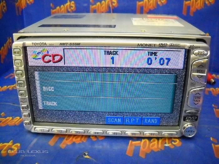

Vitanik писал(а):
Make a navigation disk photo
This is the Navi Disc.

Sorry, I don't have any others. Try to contact the author of this site: link He seems has japanese head unit. Hope he could help you.
